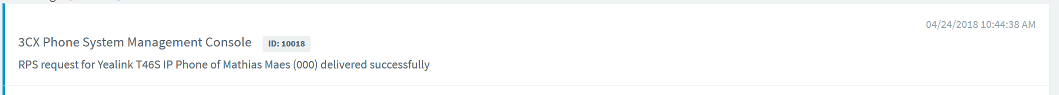

I checked the events and this shows:
So, all good I guess? But when I reboot the phone, the popup for credentials is not shown, it shows "no service" and the phone is not in the Phones list in 3XC.
