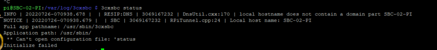

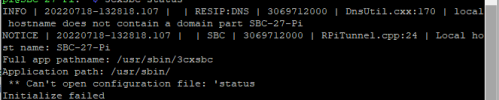

I had 2 down this morning. I did a status check and this is what I got.
All these are setup on voice vlans with fiber primary and failover circuits sub 20ms pings at all locations. I have a 2 pbx setup with failover enabled in separate datacenters. These are all new Pi 4's 4 gig with 128 gig class 10 cards powered and connected with ethernet/poe injectors. I am running them with static DHCP leases but connectivity cant be the issue as I can ssh into the units and do updates/reboot to bring them back online. There should be a watchdog service built into these to restart the service if the tunnels go down.
