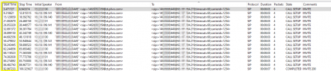

Here's some of the info in Wireshark pertaining to one of the test calls if anyone else is interested. It is indeed clear that the 3CX server is made aware of the call being placed within seconds of hitting SEND. The recipient (me) doesn't get the call in this example for almost 1.5 minutes.
Update from 3CX. Sounds like they are trying to get ahold of someone at 3CX directly and have been unsuccessful thus far. Here's the most recent message received from Nick, who has been very helpful:
Hello Jeff,
Thank you for providing the PCAP from your call. Normally when a call comes through from any SIP PCAP this is what we would normally see for a successful call
Plivo ---> SIP Invite (Header Key Value Pairs have specific details regarding the call, Body Key Value Pairs help us determine the CODEC that will be used for the audio stream) is sent to 3CX
3CX <--- address sends back a 100 trying message, a Ringing status, or a 200 Status OK to Plivo
Plivo ---> Sends an acknowledgement that it received the 200 Status OK to 3CX
Past this point the call is connected and audio is established.
What is happening currently is the following:
Plivo ---> SIP Invite to 3CX
Plivo <--- 408 Request timeout is sent back to the Carrier
When Plivo is sending the Invite we are not receiving a response from 3CX. This is causing the request to time out and in some cases you will not get a connection and the call will fail. In other situations, after multiple attempts to connect, Plivo receives a response back from 3CX and the call is connected, this is situations where you witness a long delay before the call connects.
Now the problem here as mentioned before, is not necessarily on 3CX not sending a response, it is very likely the issue is with the data being sent in the header fo the SIP Invite. What our engineering team has been working on has been to identify what in the header might be causing 3CX to not respond.
Our engineering team had been trying to reach out to 3CX, however in answer to a forum post I see that was started about this issue today 3CX reached out to work with us on this issue. We have been trying to get in contact with them since they reached out but have not been able to connect yet. We are still working on the issue internally to understand what is occurring so that we can work on implementing a fix for it as soon as possible.
