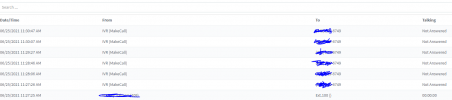

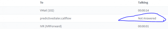

I have a problem in setting up my predictive Dialer, I create an extension to call the Predictive Dialer to 100 but then when I call the said extension it will not answer and it will connect to Voicemail and Operator, what am I missing?

You should set a free extension number to your CFD app, from the Build > Project Extension menu. Then, when you upload your dialer to 3CX, it will use this extension. You need to call this extension number once in order to wake up the dialer. You can do this from your normal extension, you don't need to create a special extension for this.

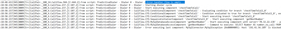

I'm sorry, here is the log file on Call Flow
Hi Edo,
I just look at the Log File it says Error Handler Flow is Empty1623096187457.png
This is the error you're having, taken from the log you sent:
2021/06/02 13:22:12.041|945|0049|Err|CallPair._100_4.Callflow.237.[C:107.2]-From script: PredictiveDialer - Dialer 0 - Dialer - Error executing last component: MySqlConnector.MySqlException (0x80004005): Host '192.41.56.189' is blocked because of many connection errors; unblock with 'mysqladmin flush-hosts'
