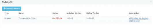

Hi @ChrisC_3CX I am unable to upgrade to V16.0.8.16 via the Management Console.
