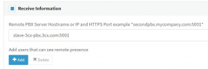

To quickly go over the basic configuration required for getting this to work:
1. Make sure the bridge connection on the Master PBX has the following enabled:
"SIP Trunks >> Bridge >> Edit >> Presence":
Note: Users to see presence must be added.
2. Make sure the bridge connection on the Slave PBX has the following enabled:
Note: Users to publish presence must be added.
3. Make sure that the extensions on the Slave PBX generally have rights to show their presence information to other extensions:
"Extensions >> Edit >> Rights":
All settings are like this Chris
