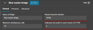

thanks for you response, i have prefix of "0" in the bridge configuration. What additional information can i provide you for a better understanding of the problem?
Thank you
Can you provide screenshots of your bridge configuration on both ends? And an example call flow of who called who and what showed up on the phones.
