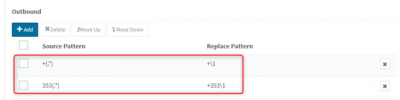

Try the following configuration on the Telnyx SIP Trunk that is used for the Outbound call:
1. Go to SIP Trunks.
2. Edit the Telnyx SIP Trunk.
3. Click on Caller ID.
4. Add the following two Outbound rules in the exact order shown:
The first Rule simply checks for Caller ID numbers starting with a + sign and leaves them as is, and the second one checks for Caller ID numbers starting with 353 and adds a + sign to them.
Let me know if you can reproduce the same issue after implementing the above.
Reactions: slapster
I'm very happy to say that this has worked! Thank you so much.

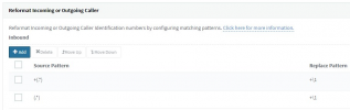

Regarding the matter at hand, you might actually be able to use a more generalized rule to reformat the Caller ID and avoid having to identify why calls are being received in this format altogether. The ones I provided earlier would handle numbers already containing the + sign and Irish numbers. Provided that all numbers you receive already contain the country code and are only missing the + sign, what you could do is just use the following instead:
The first rule will match any numbers already containing the + sign and keep the number as is. The second rule will match the rest of the numbers and just add a + sign to them.
Note: You can scrap the previous line used specifically for Irish numbers.
Could you give it a go and let me know if this works for you?
Unfortunately this blocked outgoing domestic calls :(
I tried putting a rule in between the two: Source: 0(.*) Replace: +44(.*)
That allowed outgoing domestic but blocked domestic forwarding. I don't understand why.
