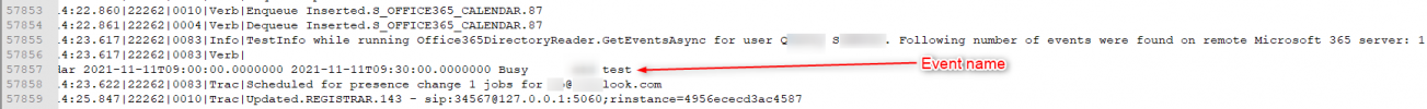

First I want to explain from a top-level, how the sync works. The communication is bidirectional, meaning that both 3CX contacts MS365 to get updates (when you press OK, when System Service is restarted, daily at 04:00), but also MS365 is supposed to send updates to 3CX when something changes.
From the description, it sounds as if when something changes on MS365, the 3CX is not getting notified, or at least, not getting notified on time.
I have a few things to suggest:
  • Make sure your Firewall is not restricting any traffic on the HTTPS port (default 5001)
  • Turn Verbose logging on, then after such an occurrence, check the SystemService log file. By searching with the Calendar Event title/name, you should find exactly what information 3CX receives and for when its scheduled. This way, you could check for when changes are made.
    Example:
  • When V18 Update 2 comes out, install it. We have made some tweaks to the way updates from MS365 are handled.
We have spent quite a bit of time trying to replicate the issue you are describing, without success so far. That does not mean there is not something there, just that it needs more investigating.
For this reason, I would highly suggest, if you have noticed this happening on a regular basis with a pattern, that you contact your 3CX Partner/Reseller, who can work with you and liaise with our Support Team to get all the information needed and processed.
