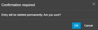

As a test, go to your system prompts and click manage prompt sets
Select a random language as the default, (DONT CLICK OK!!!!!) and delete the prompt set. Confirm that you want to delete the prompt set.
Why are we doing this? And why a random language?
Well first of all, we want to see that the other prompt sets arent affected. So we want to test with a language set you arent using.
Now go to updates. Youshould see that prompt set available for download as a new prompt set.
Does this one download?
If this one succeeds, and you are brave enough, then you can try this on your UK English prompt set too.
Worse case scenario, these get deleted and you will revert to the US English prompts.

Hi Nicholas, thanks for your reply.
Yes, I was able to delete another language and download it OK so did the same with the UK English and it appears to have been successful.
