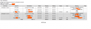

On another note, I've pulled off these 2 reports.
Can you tell me if i'm interpreting it correctly?
on 27th March there are 173 calls in the queue.
88 Abandoned I need clarification on this terminology - this include failed QCB? - what is abandoned? if 21 are failed QCB does this mean 67 called the queue and hung up before it was answered/requested QCB?
106 of these calls requested a call back and 85 of them was successful.
What constitutes a failed QCB? Wrong number? Didnt answer? If they get to VM does this count as a successful call?

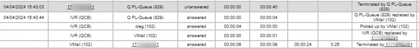

and in the report, you will see something like that :
where you can see keywords, such as "replaced by VMail" and "Picked up by VMail" (just in case you see some of the mismatches, you could use them to search for the calls)

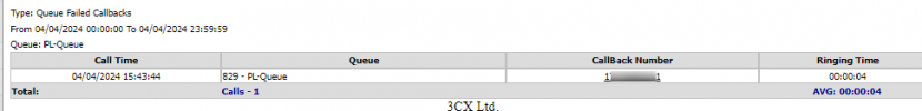

and here is the report of Failed callback of the above:
