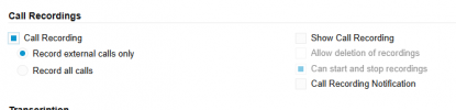

As I am reading it, and from an initial safeguard I have deselected Show call recording on the sensitive users (Owner and head of HR) like so:
I think the next thing I would need to do to remove the possibility of cross department managers having access to other department manager recordings would be to remove all the users from the "default" department. My concern of this would be what am I potentially removing from their accounts by doing this.
