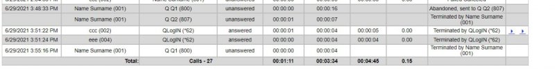

For queue B then, is there a way to distinguish between calls that came directly into the queue and calls that overflowed INTO the queue from queue A?
The Call Report will show details about where the call transferred to after being abandoned. If the call was hung up it will state Teminated by [caller] and if it overflowed it will say Abandoned, sent to [other queue].
