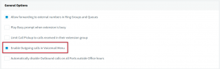

Hi @aws2p
Please navigate from the Management Console >> Settings >> General, and ensure the option "Enable Outgoing calls in Voicemail Menu" is enabled and try again.
Thank you Nikolas, got it renabled, working fine.

Interestingly a few weeks ago we had a client claim it stopped working. No apparent reason since 18u7 was installed like 3 weeks before that.
My understanding from that thread is it’s disabled by default for security reasons so a hacker/inbound caller can’t make outgoing calls by guessing a PIN.
It would make more UI sense to not offer that option to dial out if the feature is disabled…
