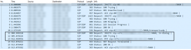

Thx for the reply. I've included a screenshot of the capture for the failed call
From my experience i cannot see anything wrong, just that 3cx does not acknowledge the re-invite. I also did the firewall checker and all seems to be 100%. Do you have anything else i can check?
