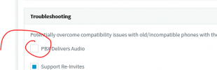

Have you tried turning on "PBX Delivers Audio" under each extension > Options?
