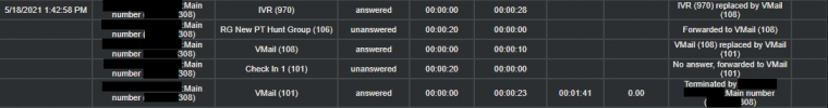

For multiple ring groups, it is set to transfer to an extensions voicemail if no one in the ring group answers. Somehow, after the call enters voicemail it is sent to ext. 101. Different ring groups routed to different voicemail boxes do the same thing.

Regarding the issue with calls getting sent to extension's 101 voicemail, it may be that extension 101 is set as the Operator extension and callers are pressing *(asterisk) while listening to the voicemail message of the original vmail box. You can check which extension is set as the operator of the 3CX PBX by navigating to "Settings >> General", check what is set in "Operator Extension". If this is the case, you could maybe have the operator extension forwarding rules end the call and change the voicemail prompt of the voicemail accordingly.

Thank you so much, and sorry for the late response. I think this is exactly what's been happening. The default voicemail greeting instructs people to press star to speak to the operator, which was indeed 101. I am working with the client to replace the greetings.
