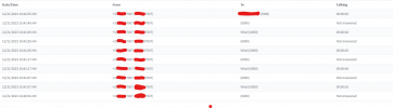

Attached is a screenshot of today's Call logs, we see that the same number tried to reach her several times and later succeeded after several tries.
Still in the call logs we see that several calls were routed to operator extension 0000 while at no level (except at the trunk level with the main number) is there routing to the operator extension, and this is really random.

I have just made a capture log and the calls which pose problems I have in destination "Anonymous" <sip:[email protected]>, except that a few minutes later the same number when he calls back manages to reach the extension so the question is to know if it comes from a configuration of my 3CX or if it is at the level of my SIP provider OVH.
Below is the packet capture. we see that in the SIP header at the new "To" field there is no number entered.
PS: i replaced the real numbers by XXXX
12/27/2023 10:13:41 AM - Call from "+339XXXX7007" <sip:[email protected];user=phone>;tag=24352-ZG-e27cde70-08bf34904 to "Anonymous"<sip:[email protected]>;tag=2b84c24a
