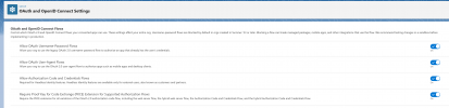

I checked the OAuth Settings and found that the "Require Proof Key for Code Exchange (PKCE) Extension for Supported Authorization Flows" Function in Salesforce under OAuth and OpenID Connect Settings was not activated.
After the change of this setting the error was gone.
Unfortunately, I get now the Error Code "Error occured: Value cannot be null. (Parameter 'key')".
Error in the Url: "/api/oauth2crm?error=invalid_request&error_description=missing+required+code+challenge".
What can be the cause of this error?

Sorry, I was too slow with the editing of my posting.
Yes, I turned off the Functions "Require Proof Key for Code Exchange (PKCE) Extension for Supported Authorization Flows", and the "Require Secret for Refresh Token Flow".
IP Relaxation is set to "Enforce IP restrictions, but relax for refresh tokens".
After these changes, I got this error:
It's not receiving the auth code to grab the refresh token.
See "Code set to" and then the error is the code is missing.
