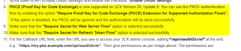

The integration is straightforward there is no need to modify the template. Ensure that you follow all steps as per guideline here and more specific be aware of the below:
in our configuration Require Secret for Web Server Flow and Require Secret for Refresh Token Flow is selected. PKCE is no selected, as it was optional. Should it be also selected?
No, you don't need that, it's optional. Are you having any issue doing the authorization? Please note that Salesforce takes up to 10 minutes to apply configuration changes, so if you adjusted the settings, you will need to wait a bit before running the authorization flow. If you still have issues after 10 minutes, share the error details so we can try to give you some pointers.

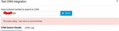

We I press authorize, I see this screen and refresh token is renewed
but when I press TEST and search by a phone number, I get the following screen
and here are the logs from 3cx:
Started scenario with empty id
Started Auth
Request text:
https://girtekaservicecloud.my.salesforce.com
Request form value refresh_token set to someRefreshToken
Request form value grant_type set to refresh_token
Request form value client_id set to someClientId
Request form value client_secret set to someClientSecret
Response text: ********
Response finished
Variable AccessToken set to someAccessToken
Variable ExpiresIn set to
System.FormatException: The input string '' was not in a correct format.
at System.Number.ThrowFormatException[TChar](ReadOnlySpan`1 value)
at System.Int32.Parse(String s)
at Integration.Crm.Engine.AuthScenarioProcessor.ProcessFinalResult(ProtocolScenario scenario, IValueManager valueManager)
at Integration.Crm.Engine.ScenarioProcessorBase.ProcessMatching(ProtocolScenario scenario, MatchingPath matching, ResponseMatcher responseMatcher, IValueManager customManager, SqlQueryParameter[] sqlQueryParameter, HashSet`1 distinctMatchings, CancellationToken token)
at Integration.Crm.Engine.ScenarioProcessorBase.ProcessFoundMatchings(ProtocolScenario scenario, IValueManager customManager, SqlQueryParameter[] sqlQueryParameter, List`1 matchings, ResponseMatcher responseMatcher, CancellationToken token)
at Integration.Crm.Engine.ScenarioProcessorBase.ProcessScenario(ProtocolScenario scenario, IValueManager customManager, SqlQueryParameter[] sqlQueryParameter, CancellationToken token)
at Integration.Crm.Engine.ScenarioProcessorBase.Execute(ProtocolScenario scenario, SqlQueryParameter[] sqlQueryParameter, CancellationToken token)
at Integration.Crm.Engine.ScenarioAuthHttpClientProvider.PerformScenarioIfNeeded(CancellationToken token)
at Integration.Crm.Engine.ScenarioAuthHttpClientProvider.Create(CancellationToken token)
at Integration.Crm.Engine.CrmProcessor.GetContactInfoFromCrm(List`1 result, IEnumerable`1 scenariosToProcess, IValueManager customManager, SqlQueryParameter[] sqlQueryParameters, Func`2 filterResultsFunctor, Boolean exactMatch, CancellationToken token)
at Integration.Crm.Engine.CrmProcessor.GetContactInfo(String contactNumber, InteractionTypes interactionType, CancellationToken token)
few additional things to note:
  1. In the error client secret, id, access token, etc... are removed
  2. We are using custom developed rest api as we have a custom logic execution requirement in salesforce
The standard template SalesforceV2 doesn't use the variable ExpiresIn, so it seems you're using something custom here. You need to check how you're assigning this variable, from where you're reading the value.
Yes, as in the first message mentioned, we are using 3cx Integration Wizard to create a custom template for integration. The Wizard generates an XML code snippet where ExpiresIn variable is assigned to 'expires_in', but this value is not sent from Salesforce oauth 2.0
Why use a custom template? Salesforce is included? If you need, just copy the XML and customize it from the base template. Don't do it all over.
Then you need to remove that part from the template. The CRM Wizard will generate a template with the most common OAuth2 variant, however the actual implementation might be different, so you will need to make changes. The output of this wizard is just a skeleton, that you will need to adjust and test properly.
