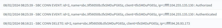

He experiences the effect that the trunk goes down upon IP-change (which is fine due to the IP change), but it takes about 10 minutes to come back up. There are only 5 IP-phones connected to that SBC.
I'm wondering whether such long delay is to be expected and whether there are ways to speed up the process.
