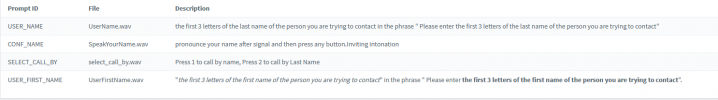

When the caller selects this option they hear an awkward prompt. “Press 1 to dial by name, press 2 to dial by last name.” I assume the first segment should say “first name” but it only says “name”. Is the out of the box voice recorded prompt not correct? Is there an issue that has not been corrected?

You'll need to ensure every user has a self id prompt recorded. The won't show in dial by name without it.
Also navigate to settings and system prompts and make sure your prompt set isn't pending an update.
After recording the self identification the lookup by name worked. Thanks for pointing out those details and providing the online support document.
I did see a pending update for the United States voice prompts and I applied them. Callers still hear the “Press 1 to dial by name, press 2 to dial by last name.” I assume the first segment should say “first name” but it only says “name”. Is the out of the box voice recorded prompt, with the latest updates applied, supposed to be this way?
You can create your own set and upload the files.
