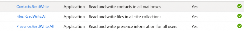

Thanks for sharing your info, we also did perform a reconfig of the integration and did not get any errors, I have also double check the app permissions as below. Still getting the same error!
