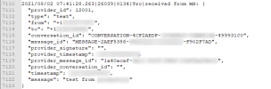

After sending a SMS to the shortcode number, open the "3cxManagementConsole.log" file and search for something like this (I usually search for some words that I sent in the SMS from the sending side). You should find something like this:
Do you find something like this?

Yes, best way is you from your own mobile send a test SMS to the number, wait 60 seconds, then check the log file I mentioned.

I don't see anything like that. Do I need to set it for verbose to see that?
Thanks, I am waiting to hear back from the customer. I was able to receive a short code message on my Telnyx. Below is log. I changed number to protect it getting out.
2021/08/02 14:34:42.785|25346|0070|Trc|received from MS: {

That's right, you got the right section of the log, so best check with the customer if they are seeing something like this in their log.
Before doing so though, best confirm with Flowroute if indeed they don't support incoming messages from short code numbers.
Flowroute support states they don't support short code SMS.
