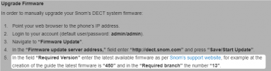

Hi Pietere,
I think you may have misunderstood slightly, the version is an example and currently this is out of date.
Following the guide should direct you to the snom website that now has the latest version V520B1
Kindly upgrade your firmware as per the guide and try again. Make sure to factory reset first, then upgrade, and then provision as a final step. Let us know if this improves the issue
https://www.3cx.com/sip-phones/firmware-update-snom-dect/#h.3mhzswa7qehc
