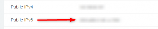

@slapster thank you for the feedback, we will forward this to the relevant department to add IPv6 also in this section.
Just for you to also know, there is no need to copy-paste IPv6 as if you go to https://customer.3cx.com >> Instances and you scroll, you will see on the left side your IPv4 & your IPv6 :
Great thanks. As the 3CX dashboard is a convenient place to get the IPs from in order to paste into the GCloud console, I was talking about that. It's strangely difficult to select, as it grabs the field label as well!
@slapster FYI your observation for the copy - paste of IPv6 in the Dashboard has been taken under consideration and in the next update of V18, this will be available !!
