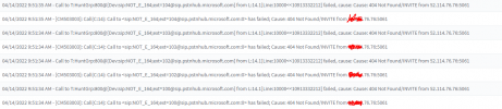

Also from calling 3CX client to Teams I get:
04/14/2022 10:04:34 AM - Call to T:Extn:104@[Dev:sip:NOT_E_164;ext=[email protected]] from L:20.1[Extn:100] failed, cause: Cause: 404 Not Found/INVITE from xx.xx.xxx:5061

But can't get incoming calls working on teams. On 3cx client it is ringing but on teams not.
Getting same error: Call to T:Extn:104@[Dev:sip:NOT_E_164;ext=[email protected]] from L:20.1[Extn:100] failed, cause: Cause: 404 Not Found/INVITE from xx.xx.xxx:5061

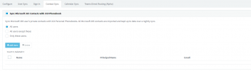

I also see that 3CX contacts are not visible inside teams or I'm looking on wrong location?
