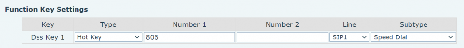

looks like the door entry function key type was wrong. it was set to PTT, so when ever someone held the call button slightly longer it would call and then on release it would hang up the call. Changing the settings we've been able to replicate the problem. Changing the to type to Hotkey seems to be working fine.

If set like this, it should be OK. Just replace 806 with your destination
Also make sure you have correctly provisioned the product:
1. Model must be i20S not plain i20
2. Add your destination as a Custom Speed Dial
This will ensure that the correct settings will end up on your device. Make sure to factory reset it first, because leftover wrong settings might still remain from before.
