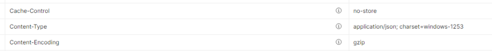

I am sending a post request to my CRM and I receive the following response.
I know that the request is correct, because when I try the same request from Postman, I receive the correct response.
The response is compressed and the content type is application/json with charset=windows-1253; as you can see below.
Is there a problem with the charset, because it is not the usual utf-8, but the windows-1253?
Is there a problem, because the response is compressed?
I can't change the charset response to another encoding, it is hardcoded from the CRM.
Is there a way to decode the response?
Thanks in advance.
Most probably the issue is the compressed response. I don't think it will work. I never saw a CRM returning a compressed response, you should try disabling that.
I don't know if I can disable the response compression.
The 3cx does not support response decompression?
No, this is unsupported. In that case you will need to create a kind of proxy, so you invoke this proxy between 3CX and the CRM, and this proxy makes the real call to the CRM, decompress the response, and returns a plain text response to 3CX.
