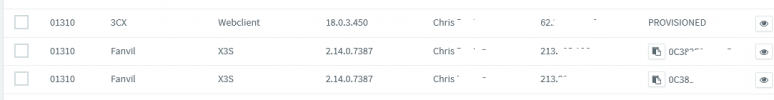

I'm looking into an issue where someone is working from home and his phone isn't ringing at all yet calls seem to be going to it and the app is working ok. The phone is set as the main device but what I'm unsure of is that it is showing duplicated, same mac and IP address and I can't see a way of deleting one of them?
Is that likely to be the issue?
I just checked again and there were 5 instances of it in there this time, all duplicates.
