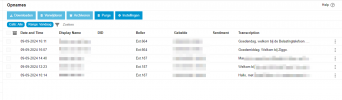

Thanks for the suggestion!
I took a look at that, but it doesn't seems that's the issue. OpenAI reports very few API calls and TPM in the logs
Also, it doesn't seem to matter if a call is long or short, it just stopped summarizing.
The 3CX instance is still in pre-deployment, so it's not used heavily.
As you can see, the bottom three calls have been summarized and then it just stopped for no apparant reason.
The transcription still works fine though.

2024/09/09 14:41:09.126|0052|Info| [Npgsql.Command] Command execution completed (duration=1ms): select * from recordings join recording_participant on fkid_recordings=recordings.id_recording where id_recording=$1 order by id_participant 2024/09/09 14:41:09.156|0052|Info| [System.Net.Http.HttpClient.Forge.OpenAI.LogicalHandler] Start processing HTTP request POST https://api.openai.com/v1/audio/transcriptions 2024/09/09 14:41:09.156|0052|Info| [System.Net.Http.HttpClient.Forge.OpenAI.ClientHandler] Sending HTTP request POST https://api.openai.com/v1/audio/transcriptions 2024/09/09 14:41:12.732|0027|Info| [System.Net.Http.HttpClient.Forge.OpenAI.ClientHandler] Received HTTP response headers after 3575.6055ms - 200 2024/09/09 14:41:12.732|0027|Info| [System.Net.Http.HttpClient.Forge.OpenAI.LogicalHandler] End processing HTTP request after 3575.9989ms - 200 2024/09/09 14:41:12.758|0027|Info| [Npgsql.Command] Command execution completed (duration=2ms): update recordings set transcription=$1, summary=$2, sentiment_score=$3, result=1 where id_recording=$4
You can see the call from 14:40 being transcribed in the above log-file and screen shot.
Everything seems fine, it's just that sentiment and summary aren't generated.
There aren't many calls on 3CX yet, because it's still in pre-deployment. OpenAI doesn't report any rate limits triggering or anything.
I also rebooted 3CX and that didn't help either.
If you have any further suggestions, that would be really helpful!
