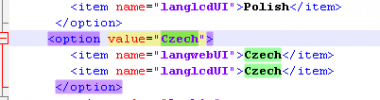

Is it possible to fix an error in the settings of the official 3cx template for yealink T4X...
from
<option value="Czech">
<item name="langwebUI">Czech</item>
<item name="langlcdUI">Czech</item>
</option>
to
<item name="langwebUI">CzechLang</item>
<item name="langlcdUI">CzechLang</item>
</option>
export cfg from phone if i manualy change to Czech
I would like to use the official template and not make differential changes and revert to my own modified templates after every server update just because of the language which is wrong.
Thank you

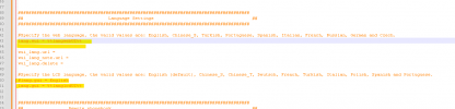

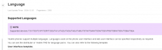

Hello again...
the header already has a list of supported devices...
Yealink just confirmed to me in the last communication what I'm trying to solve here, that is, until the template is corrected/modified to the correct name, the settings will not work...
From my position I have nothing more to ask of Yealink... now the ball is in your court...
By mistake the template is with you, not with Yealing
is expected
I have verified the same settings on older versions of Yealink T27G
thank you
