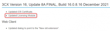

Hi @oakley,
Take a look at the Build History / Change Log:
I believe that this should work for you.

Updating version 16.0.8.9 to 16.0.8.16 resolved this exact issue for us. Thank you.
