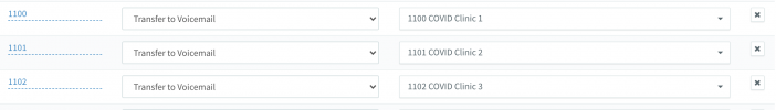

I am switching off a third party system this week that integrates into a 30 year old telephone system, this system manages their voicemail as they dial 2030, enter their ID and password to listen to their voicemails etc. However I am trying to duplicate this on 3CX and it is very time consuming and I was wondering if there is a quicker way via a CFD or something?
I have currently made a DTMF Digital Receptionist that has an external number that I will reprogram on the Avaya switch so when 2030 is dialled it routes through to 3CX.
I have to add another 3000 records... please can someone suggest a better way/quicker way?

Basically I want a DDI number that I set as the CFNA on the Avaya system which will route to the 3CX and it will ask "Please enter extension number you wish to leave the voicemail for"... end user enters in 3024 for example and will be greeted by their voicemail greeting, leaves a voicemail and they get an email from 3CX, etc.

I have it working on the Digital Receptionist, but it is just a lot of work lol. I was wondering if it is possible via a custom CFD taking the value the user inputs and adding a *4 in front of it maybe?
That is the plan eventually...
You can try it. Using CFD, take the UserInput (or authentication component) and then make a transfer to that "*4 + value" (make sure *4 is actually the right code, Settings > Dial Codes)
