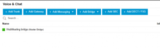

I've created a Twilio trial account, with an AU phone number.
And below is the screenshot of the 3CX
I am 99% confident (because it happened to me too :) ) that the error you are getting is from Twillio, since their system for trials allows only 1 trunk, and our automated Twillio template is set to create a new trunk with them via API - simplest solution, delete the trunk you created on Twilio and run through the 3CX wizard again - any DID you had can be attached to the new trunk.
