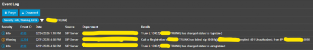

A trunk is configured with 126 seconds as the re-register timeout but it doesn't re-register until I manually select "Refresh registration".
I have had this happen a few times already with two different trunks on separate occasions.
I'd appreciate any help.
