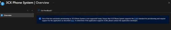

no, you cannot, only from 3cx webUI
if you try you get this
if this is still not what you meant you will have to be clearer
