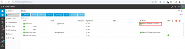

I believe that previously it was possible to add an IP phone directly because I was able to connect directly via MicroSIP and Intelbras ATA 200 and TIP125i, but currently on the 3CX Free SMB screen the option to connect directly is no longer avaliable (the option I used when I created the extension), I believe there has been some update in the last few months, remaning only the option to use SBC.Captura de tela 2025-04-11 232227.pngCaptura de tela 2025-04-11 232332.pngCaptura de tela 2025-04-11 232528.png

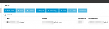

I hv the same problem on the IP phone model, I can choose Generice IP Phone model, but it can not now.
If I didn't have IP phone, how to use 3CX system again?
If you don't have a physical phone you can use a web browser, or 3CX mobile app, or Windows Store 3CX app.
Since I didnt have a physical phone, it can not setting up a Phone Model to the system. The user can not connected and the 3CX mobile app also didnt work.
