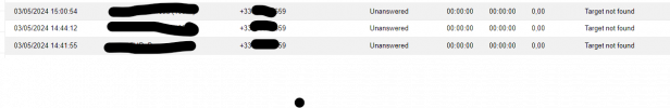

once I want to call back with BIS on the phone, I get a windows "Not found".
If i dial manually the French ten digit number it works.
what I do wrongly not to be able to use BIS feature directly without failure?

SIP provider don't see call back traces, they see incoming call only.
There is nothing in even log related to the outgoing call back, (like I did nothing) I only see the incoming call

If I dial manually +33415600200 I get not found
If i dial French format 10 digits 0415600200 it works
So as these call back doesn't reach the sip provider it's necessary locked on SMB no ?

Well my bad, it was the outboud rule, I forgot the + :mad:
Now it works fine, really small details that can let you waste a lot of time even when they are in front of your nozexD
