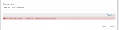

Trying to do an upgrade / move to Digitalocean and had to restart from backup on a new droplet a couple of times. Now I finally have the right server size and config (with IPv6 enabled), but get the following error:
Unable to connect with 3CX License server. Check your network and try again.
Is there a limit on the times one can contact the server per hour/day/month?

Ok, did some testing.
Disabled the droplet and created a new one with only IPV4, which went without a hitch.
Then tried to make a another one with IPV4 and IPV6 address and get the error again while uploading the backup.
Could it be that the license server does not work as well with IPV6 machines?
All 3CX-hosted machines have IPv6, so it should not be the case.
