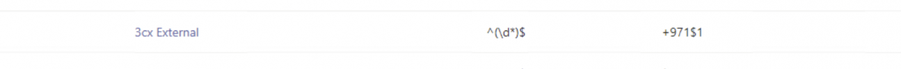

Hello Nick,
I added following rule to 3cx.
This is my team dail plan
As there was no option of UAE dail plan i choose other at time of office 365 setup.

You did your best effort to make things work. I really appreciate your help. Issue is now resolved.
Following are the step performed.
1. Disabled E.164 feture from 3cx (Got info from this forum Link:- https://www.3cx.com/community/threads/e-164-and-outbound-rules.81884/)
2. Added rule as you said on 3cx
3. Added following rule in team dail plan
And call start working.
