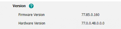

What is the firmware version of the base?
Yes local ip from base, All off the extension status is available and not only ext 005 cant ring but all.
