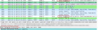

Here is a fragmented Invite to the PBX which is way way above the MTU and its in UDP. The PBX receives it and replies with 200 OK correctly. I intentionally switched SRTP on and IPv6 to make the packet larger and exceed the MTU.
Of course that does not mean you should rely on this. If you can reduce the size of the packet that would be the best case scenario. See if you can remove codecs or SRTP if present from the providers side.
