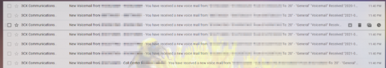

Hi Folks, I'm getting some odd behavior and am a bit stumped, hoping someone here might be able to help. We're set up to use Google Voice to Text transcription for emails, and for the most part it works totally fine. Voicemail comes in, gets transcribed, and gets delivered to the user. Weirdly though, we will periodically get a flood of email notifications in the middle of the night from old voicemails, with no transcription attached. This seems to align with points when the 3CX server is rebooted, or possibly when the nightly backup runs, but not sure if it's related or just coincidental. Any ideas what's going on?

Looks like it's the same 7 voicemails, every night at 11:40 on the dot. Our backup runs at 1 AM, so it doesn't appear to be triggered by that.
All of the voicemails are on the same extension (the general mailbox), and they are still in the mailbox (along with many other voicemails that don't get resent every night). They all look to be 1-3 second empty messages, dating back as far as last December. I've tried just deleting them out of the mailbox, but they don't actually clear when I do. No error message, they just don't disappear after deletion.
