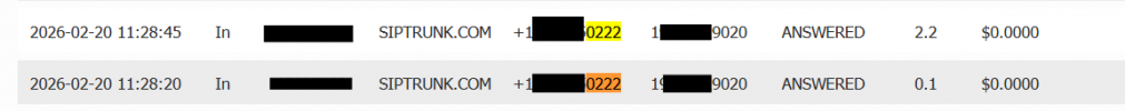

The first entry above with the number ending in 9683 is not a number that I recognize and is not listed in the PBX at all. I did check the CDR with the SIP provider and they dialed the number ending in 9020 both times.

I have also spoken with the carrier and they advised that they are receiving the following information when one of the calls comes through:
Code:
02/23/2026 10:44:53.461 -05:00: XX.XXX.XX.XXX:5060 -> XXX.XXX.X.XX:5060
INVITE sip:[email protected]:5060;rinstance=29a223c8bfea6d67 SIP/2.0
To: sip:[email protected]
From: "CALLER" sip:[email protected]
Call-ID: [email protected]
CSeq: 487571 INVITE
Contact: "MERCY ." sip:[email protected]:5060
Diversion: sip:[email protected];reason=unknown;screen=yes;privacy=unknown
Privacy: off
P-Asserted-Identity: "CALLER" sip:[email protected]
"Do note that the Request URI header does contain the proper destination number 1XXXXXX9020. To accept these sorts of forwarded calls, I recommend checking with 3CX support to assist in configuring your trunk to have it read off of the RURI header for inbound calls. "
