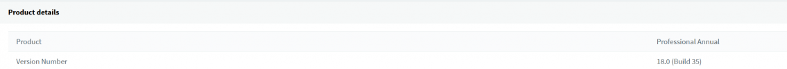

Would be super helpful if you would tell everyone how to tell if you have V18 U9A or U9B. One client says 18.0 (Build 35).
I don't understand why this is so difficult. Searched all over the internet and can't find how to tell what version this is. That's 20 minutes I'll never get back. Should have taken 30 seconds.
Finally tried AI search and it says 18.0 (build 35)=V18 U9B but I want to make sure. Please confirm.
Again, why is this so complicated.
And again, please confirm that this V18 U9B doesn't need to be upgraded ASAP and will not be affected by this SSL Cert change. It's tax season and the client has said DO NOT TOUCH OR CHANGE ANYTHING UNLESS IT IS AN ABSOLUTE EMERGENCY. We will update to 20 after tax season is over.
Thank you for the information. That link is the first place I looked. It mentions nothing about (build 35) which is why I was irritated. A google search for "3cx 18 .0 (Build 35)" isn't helpful either. I'm just saying. I copied the version directly out of 3cx and couldn't easily verify which version I had from a nemail from 3cx.
Now that I'm not busy or on a phone call I do see that it says 18.0.9.35. I was searching for build 35 as it says in 3cx version page. I'll own that one. My point is why aren't they EXACTLY the same.
