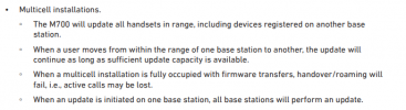

I've been searching for the proper procedure for updating firmware in multicell DECT setup with SNOM M700 bases.
All base stations are currently running v450/13 pr. this guide - we have the same firmware in production at other sites without issues.
https://www.3cx.com/sip-phones/firmware-update-snom-dect/
SNOM has released newer firmware, v500/1, v501/1, v510/1 and v520/1, but I cannot seem to find any guides on how the upgrade procedure works in a multicell setup.
Do I just update the master base, and then all base stations receive the new firmware as well, or do I update all base stations one by one?
Btw. I'm aware that a direct upgrade from 450/13 to 510/520 is not possible - it needs to be a two step procedure though v500 or v501 first.
https://service.snom.com/display/wiki/DECT+M-Series+Firmware
I'm not in any hurry to update - I just need the way to do :)

I have a few M700 and M65 running 520/1 and haven't had any issues. We only use basic functions on them. Make or receive call and transfer.

Cool - thanks for sharing. I don't anticipate using any fancy features either. A basic on-prem 3CX install with a handful of M25 devices connecting to 5 cell multicell setup.
Only reason for using that many cells is the layout of the building and need for roaming.
