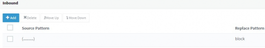

You could also potentially utilize the Caller ID reformatting feature on the SIP Trunk level. For instance, if incoming numbers with length of 10 digits and up are always scam calls, you could add an incoming caller ID reformatting rule to match all numbers with length of 10 digits and above:
All numbers less than 10 will fail to match this rule and therefore be allowed to go through unchanged, all numbers with digit length 10 and above will match this rule and therefore be formatted to "block". You can then add a Number Blacklist entry to match the caller id "block".

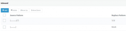

Well do keep in mind that the Caller ID reformatting method I provided earlier will catch all 10 digit numbers and above. Since you need to allow longer numbers and only block exactly 10 digit numbers, you could add a second rule(with 11 dots) to first catch all numbers that are 11 digits and above as seen below:
Make sure that the order is as shown above, so that, all calls with 11 digits and above will be matched with the first rule which will leave the caller ID as is.
Of course if you have 10 digit Caller Ids coming in for legitimate calls, you will be blocking them as well.
