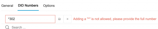

Strange but under version 18 when adding DIDs for generic SIP trunks, I was able to add things like *3025555, 302555* or *5555 and it allowed me to enter the "*" without issues.
However, under version 20, I am not able to add the the * when adding DIDs under the generic SIP trunk. Then image shows what I am talking about (v20 Update 6, build 724)

Seems like you have something else going on then. I just tested on another V20 system with a generic template and was able to add it with no issues. Could you try building a new trunk with the generic template and adding it again?

Thank you for your reply. I had tested that before and did so just now and one i enter a *, i get the not allow message.
Are you on the same version as me?
Edit: Also happening with supported trunks.
I'm running V20 update 6 on the systems I tested this on. Also tested on ones that were upgraded from V18 to V20 and ones that were installed as V20. I tried both older trunks using the Telnyx config from when it was a supported carrier as well as ones built from the Generic template.

It's an On-prem Linux box with the Enterprise LIC.
Interestingly enough, I just tried it on another v20 on-prem but with windows server and it accepted the * without issues. Very strange.

Any idea why it is not working on my Linux on=prem install?
Would the problem install be Multi-Company-Mode by any chance? On MCM wildcards are not permitted in DID import as you might end up with a common pattern for two tenants, or one tenant could end up "stealing" another's DIDs.

Hi, yes, I do have it in Multi-Company-Mode. There's your problem Alexander :)
I would love to be able to manage this myself due to my solution. If I disabled Multi-Company-Mode mode, add the wild cards and then enabled Multi-Company-Mode again, do you see any issues?

Doenst make any sence and wont work.
Simple answer, yep :)
The system will not switch, as the reasons for not having wildcards would still stand. With MCM each company needs unique DIDs. With wildcards in place that's simply not possible.
I'm sure you can make a CSV in [spreadsheet software of your choice] with sequential numbers and import them easily enough for this not to be a terrible chore. Similarly importing users with DIDs assigned afterwards can save some of that manual work too.
