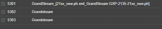

I think I figured it out when we did the upgrade, our Grandstream phones did not get provisioned with the custom profile as our Yealink phones did. I deleted out my GXP2135 on my extension and added it back in and now the pickup is working correctly from the BFL. 5301 is my extension.
